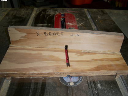

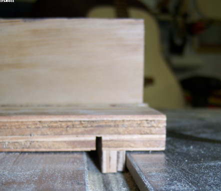

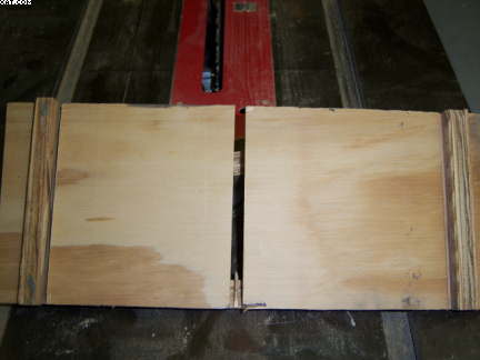

Let me start off by saying that I sent Hesh a PM and asked for  and recieved his blessing on posting these pictures before I am posting them. I dont want to appear that I am stealing his thunder. I realize that if you dont have a table saw, what I am about to show you may be useless. It is, however, how I make x-braces and I usually make several sets at one time which takes just seconds to make.
First of all, I radius my brace stock the same way he does, the difference is after this step.

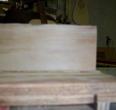

I made a jig to operate on my table saw to cut the slots cleanly and accurately.  The jig has a backstop that is glued to the main table at 8 degrees. One brace is cut radius side up and one radius side down, and they are  slotted at the same time. I place the radius side down against the rear fence and the glued on  supports that keep it "square and plumb"  can be seen in one of the pictures.
The height of the saw blade is adjusted to height before cutting and the sled was made so that it can be moved from side to side, but a controlled side movement so that it cuts the proper width slot in the braces. I think the pictures are pretty self explanitory, but if you have questions, please feel free to ask!
the whole jig
next, you can see the rear fence which is glued on at 8 degrees. you can also see the supports that hold the "radius side down" brace holder.

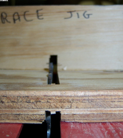

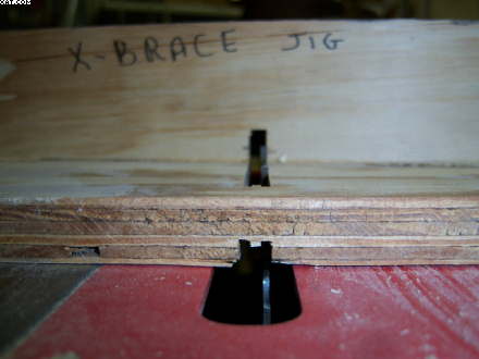

hard to see, but if you look close you can see the height of that radius side down brace holder.

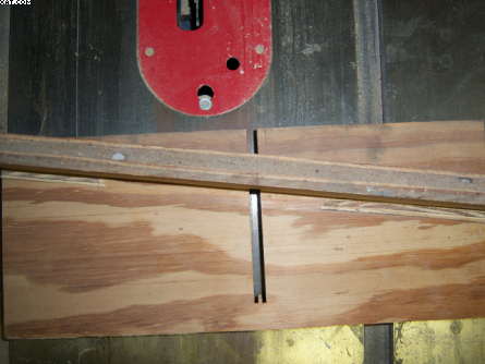

Here is a picture of the sled in the slot on the table, pushed all the way to one side. you can see that the piece of guide stock that is down in the slot has room to "wiggle". This allows the correct width of the slot to be cut. the next picture shows how much side to side movement is allowed
Lastly is a picture of the bottom of the sled
I usually make up a number of x braces at once, and just store them until needed. right now, I need to make up a batch because IA have used all that I previously made.  These braces will fit the standard x brace templates and require trimming as in Hesh's last step to get an absolute tight fit. instead of a plane I usually sand them to the proper thickness. The aqngle is correct for the standard Martin X brace. If your x braces require some different angle than this, it only takes less than an hour to make a new jig for that angle.
Hope this helps!
Ken

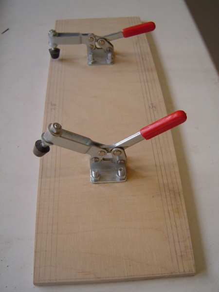

I shape the radius on my braces on the router table by clamping them to a plywood template and using a pattern following bit that has the bearing guide on the bottom.
What I don't like about shaping them on the dish is that they tend to "round over", that is their bottoms are not as flat and perpendicular to the sides as I would like. It is possible to avoid this by sanding the x-braces after they are joined, that will keep them upright, but it does not help the other radiused braces. The other thing I don't like about it is the sanded surface; a cut surface should glue better. The best would probably be to use a plane with a glued on stop to give a constant radius like Alan Carruth has described previously, but I have not been happy with my results when I tried this. The biggest problem for me seems to be to keep the plane at a constant angle to the sides of the brace, instead I always seem to end up with a slightly twisted bottom of the brace; not good.

Like Arnt, I rough out my braces on the router table with a bottom bearing bit using a home made radius jig.
Then after the notches are cut and the two halves glued together then I sand them in the dish, I also do this so that the chances of rounding are reduced.
